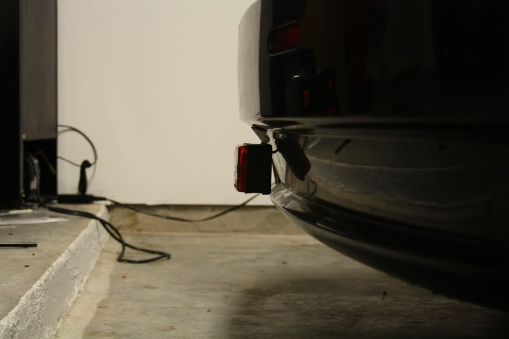

This gives you the feel of where it sits. Wish I could have found something more attractive, but this gets me legal, and I can try to find a better light later.

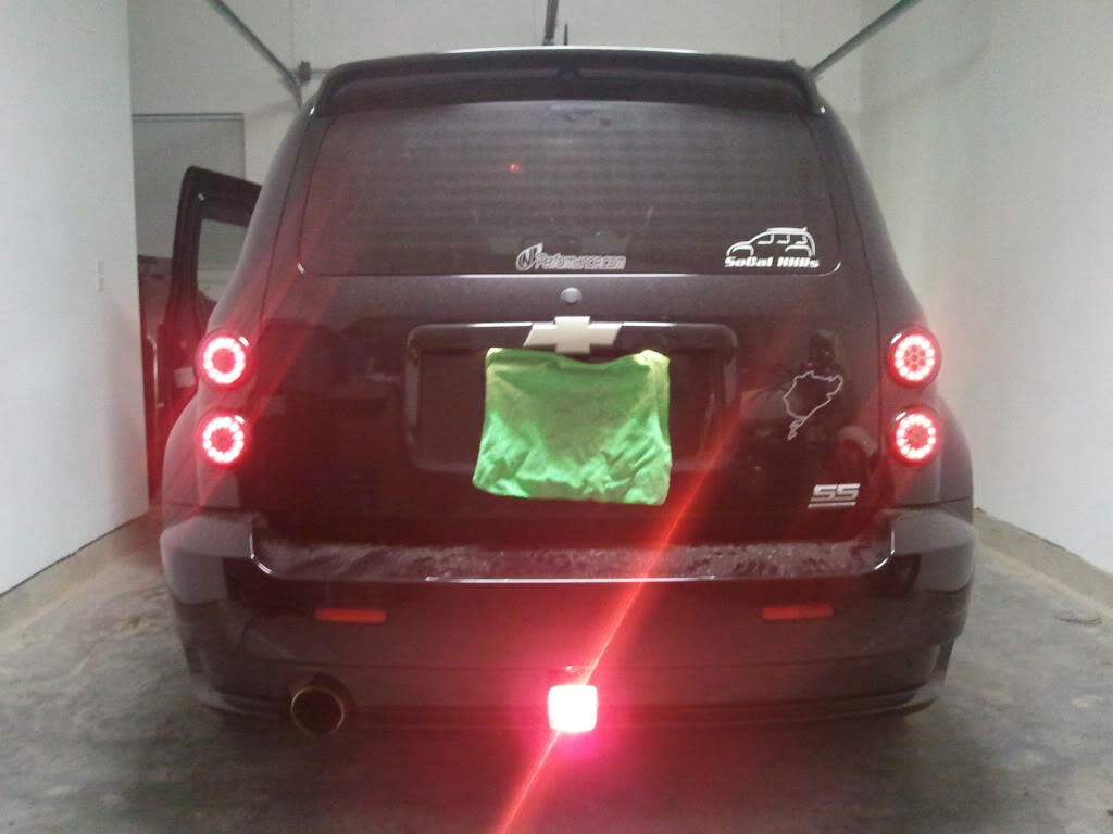

Light turned on, running lights on. It's a bright little thing! Never mind the green rag, forgot PhotoBucket lets you edit lol.

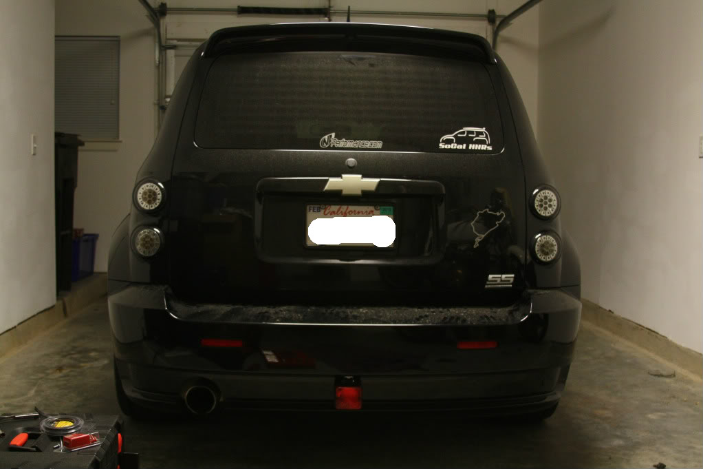

Attached on the underside of the bumper, a single bolt, and slotted the foam inside so the bolt can sit in it. Doesn't protrude as bad as I'd originally thought it would.

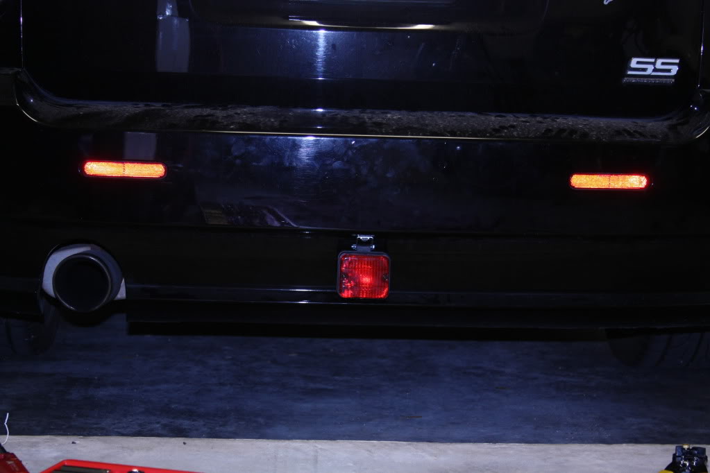

A close up down low, light off, with flash (note lit reflectors lol). Yeah it kinda just hangs out down there, but whatever.
