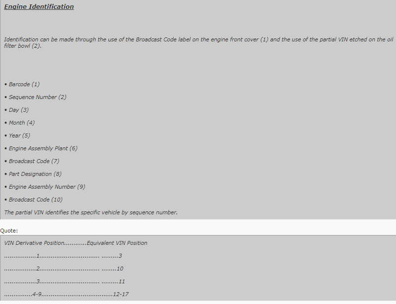

The partial VIN that may be on the motor is for the Vehicle not the motor.
Maybe there is the remains of a paper "broadcast label" on one end of the head that could lend info. Basically it will tell if it is the factory engine.
