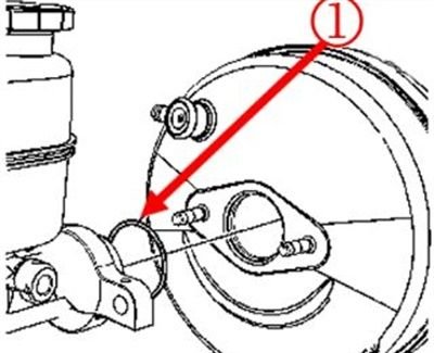

The Oring is as shown in the pic and in a wide selection of GM vehicles when failed or missing has caused a minor vacuum leak, which in turn has caused a low and/or soft pedal on braking.
The Oring may not be serviceable separately for all master cylinders, but should be included in new or rebuild masters with or without the reservoirs.
If you don't get one with the master, best choice is to take the master to a hydraulic supply house and have them match the diameter to fit. The cross section need not be too thick.
Tell the rep it's for compression and he should be able to supply you with a suitable oring.
Alternatively, they can be ordered from Grainger or MSC or any number of places, if you can measure accurately. The type of rubber isn't too important.
Metric Orings come in many more sizes than SAE Orings but not stocked as much.

That O-Ring only stops a vacuum leak.
Take the original to a quality hardware store, match it up and buy one.
Another thing you can do is install the original and start the car.
Spray the area with soap and water and see if gets sucked in. If not you're good to go.
