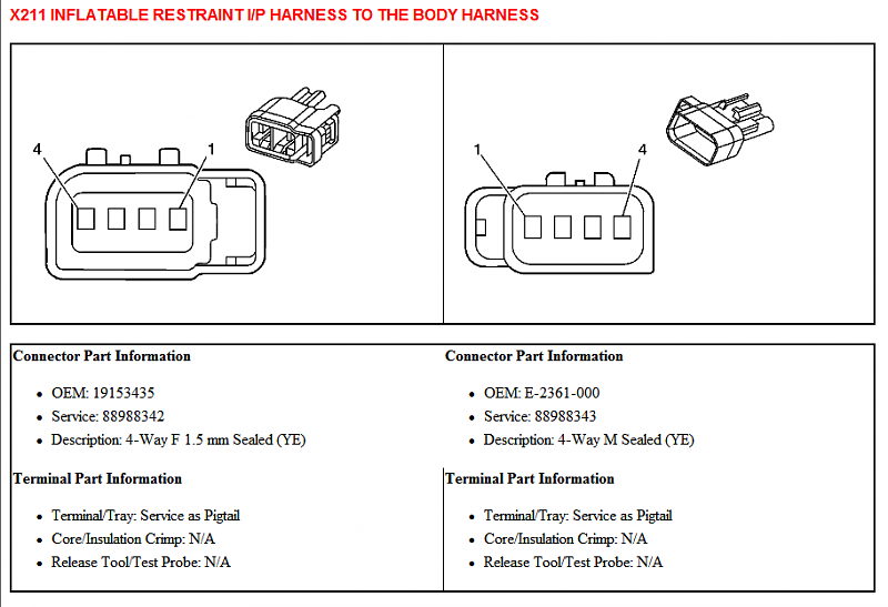

The connector that Mitchell is telling me belongs there is completely different. It is identified as X211 Inflatable Restraint I/P Harness to the Body Harness; if you are faint of heart don't even look at how much one will set you back.
