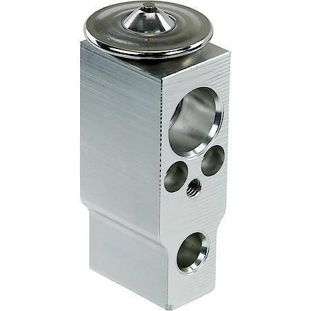

I think the expansion valve is that block in the firewall where the tubes enter/exit the cabin. Just guessing.
The 2 extra tubes and adapters are part of the GM A/C service machine. That part I'm sure of.
Correct
Here is a pic of one.
2 ports on the back to the evaporator
2 ports on the front to the high and low side lines
