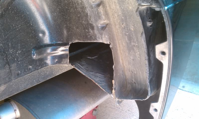

Do a search on a post I did in July of 2010. In it I detailed how to fix this problem. It's a fair amount of work but it gives you the room for larger tires. There is nothing inside those square bumps your tires are hitting. Here are the photos.

Have the hubby also look around the wheel well for other rub marks, both on the tire and the plastic liner! Also the shock bolts , gonna have to jack it up and remove the wheel! Place a stand under the frame for safety please!!
