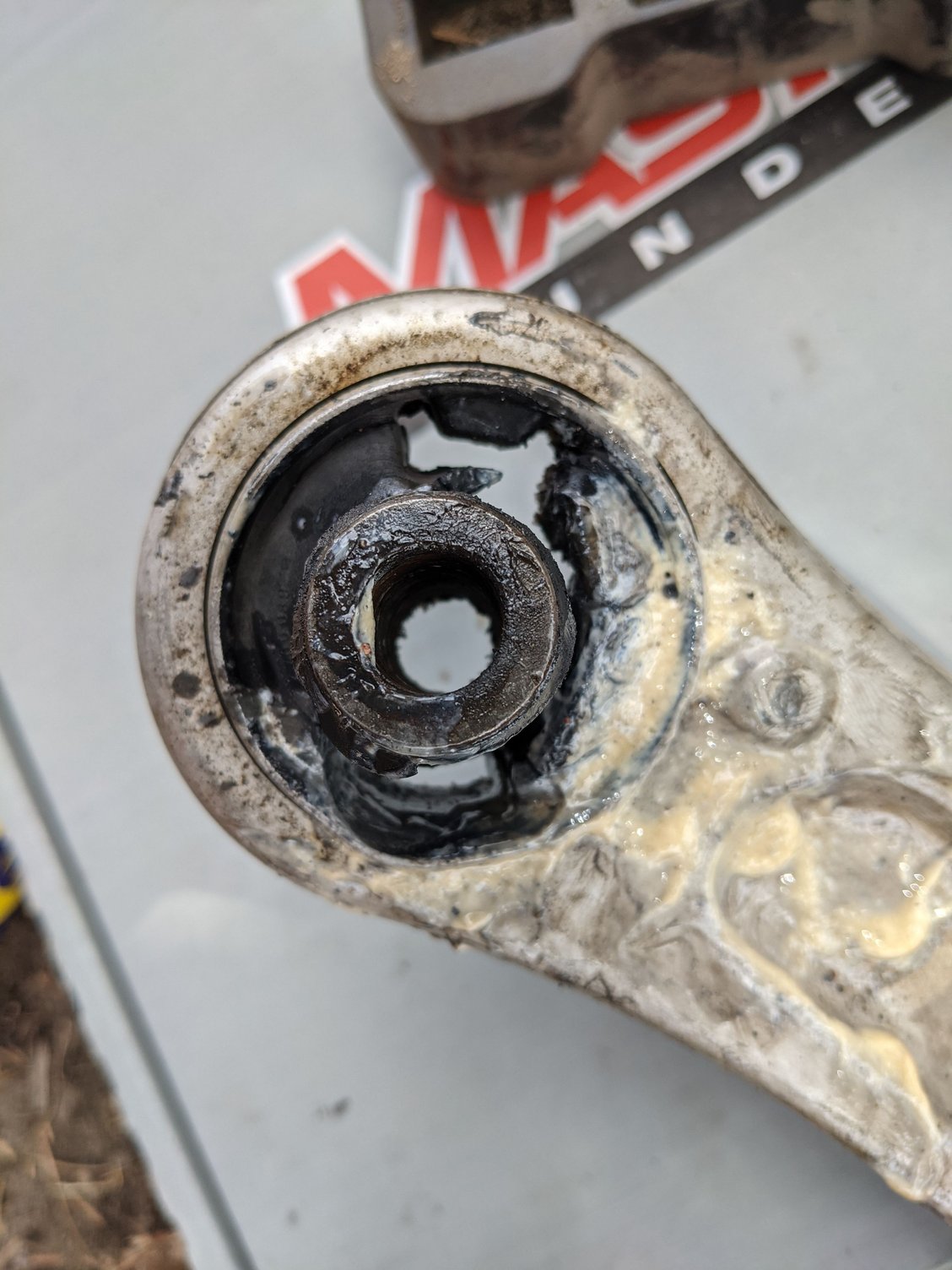

***UPDATE***
Update.
Old Apr 8, 2021 | 03:33 PM
Posts: 40,096
Awe, yeah, that one on the right is toast!!
Yeah that the old against the new. I'm having the worst damn time getting the new in one in. Nothing can be easy apparently
