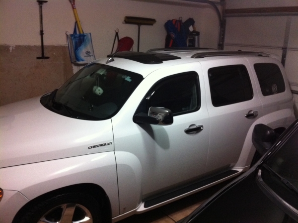

Thumbs up Benevento
Went the inexpensive route on fixing the broken deflector in my '06, & I am happier with this than the original deflector. Quieter, MUCH quieter, & installation was quick & simple!
