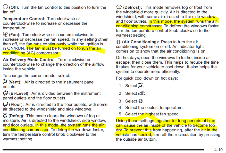

The fan switch only when in fresh air mode = no a/c just fresh air.
A/C on if A/C button lit & fan on or when defrost & fan on or when recirc mode and fan on.
The A/C will not run if the fan is off.
The A/C does run if in defrost or recirc with no A/C light.
I like fresh air, I don't like the wind in my face. If you open only the rear windows the car bucks like the engine was misfiring. Solution: run the fan A/C off in fresh air mode.
That is in your Owner Manual, in more understandable form.

And then it gets stuffy. I have only used the recirc a couple of times and did not like it. It smells bad.
The function locks out because they are trying to protect people from bad fumes. When the fresh air is coming in the air vents under the rear bumper function for "flow thru" ventilation. When in recirc noxious fumes can stay in the cabin.
From my 2011 Owner Manual:
Attached Thumbnails a/c vent temps-ac2.png
