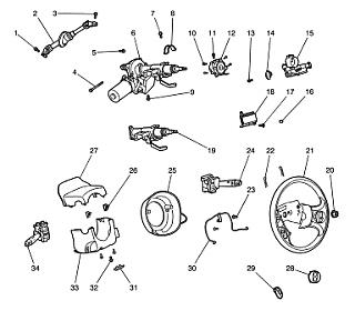

Is #12 what you are looking for?

(1) Lower Intermediate Steering Shaft Bold
(2) Intermediate Steering Shaft Assembly
(3) Upper Intermediate Steering Shaft Bolt
(4) Lower Steering Column Support Bracket Bolt
(5) Lower Steering Column Jacket Bolt
(6) Steering Column Assembly
(7) Ignition / Start Switch Clamp Bolt
(8) Ignition / Start Switch Clamp
(9) Upper Steering Column Support Bracket Bolt
(10) Turn Signal Switch Bracket Screw
(11) Turn Signal Switch Bracket Screw
(12) Inflatable Restraint Steering Wheel Module Coil Assembly
(13) Ignition / Start Switch Screw
(14) Ignition / Start Switch Assembly
(15) Ignition / Start Switch Housing
(16) Spring
(17) Ignition Lock Cylinder Control Solenoid Screw
(18) Ignition Lock Cylinder Control Solenoid Assembly
(19) Steering Column Jacket Assembly
(20) Steering Wheel Nut
(21) Steering Wheel Assembly
(22) Inflatable Restraint Steering Wheel Module Retainer
(23) Steering Wheel Shroud Screw
(24) Wiper / Washer Switch Assembly
(25) Steering Wheel Shroud
(26) Lower Trim Cover Clip
(27) Upper Trim Cover
(28) Cruise Control Resume Switch Assembly
(29) Cruise Control Switch Assembly
(30) Harness Assembly
(31) Lower Trim Cover Plug
(32) Lower Trim Cover Screw
(33) Lower Trim Cover
(34) Headlamp / Dimmer / Park / Turn Signal Switch Assembly

Yes I believe it is #12 that he is refering to. It is what the air bag, cruise control and radio controls hook into.

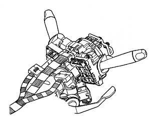

Name:  SIR COIL 1.jpg
6. Disconnect the SIR coil harness connector from the SIR coil module assembly.
7. Disconnect the headlamp/turn signal harness connector from the SIR coil module assembly.
8. Disconnect the wiper/washer harness connector for the SIR coil module assembly.

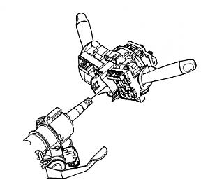

Name:  SIR COIL 2.jpg
9. Using a small flat-bladed tool, carefully pry the 2 retaining tabs away at the base of the SIR coil assembly and slide the SIR coil assembly off of the steering column.

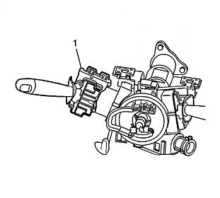

Name:  SIR COIL 3.jpg
