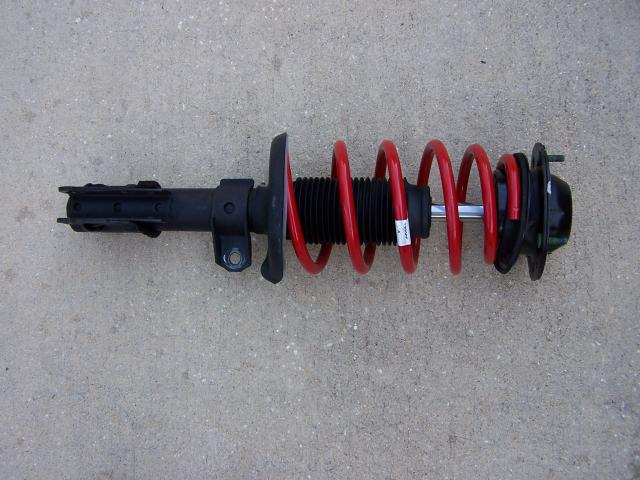

Old Jul 3, 2014 | 04:45 AM
  #139
Posts: 11,719
All HHR's have coil springs/struts in the front. The previous pictures in this thread just don't show the top portion of the strut assembly.
Name:  Front Pedders strut.jpg
