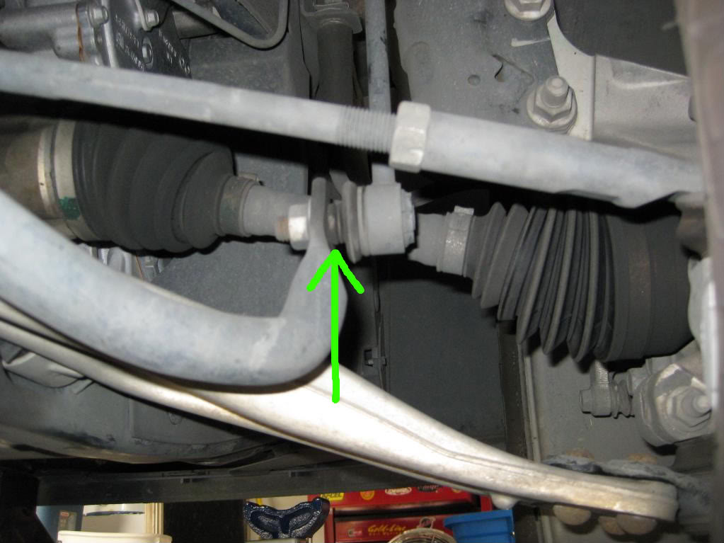

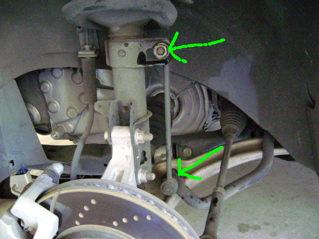

[QUOTE=Stryker;473114]Here are some images from someone who has replaced them
" I recently replaced my stock squeaky sway bar end links with MOOG #K750012 end links with zerk fittings. The new links are much quieter and have tighened up the feel of the steering."
Here's the stock end links, you'll need to jack up the front end and remove the wheel to get to this part. The green arrows point to the two bolts that will need to be removed. The outside one is easy to get to, the inside one is not too difficult to reach.

If by chance the nut spins there is a small area on the inside face of the link where you can get a grip on the bolt. On the new end links this piece is a full size nut that is much easier to work with.
I too installed the Moog units (available at Shucks auto parts in Lake Stevens WA for ~$80 - and wanted to comment on two things:
1: I was having a real problem removing one of the nuts, and ended up just twisting the rod off the ball - it was that badly worn (and rusty inside)
2: as the nuts can be a bear to get off as they are an interference fit on the threads to make them self-locking - use a dremel with a cutting wheel to cut thru most of the nut on opposite sides (two cuts) - it makes the nuts MUCH easier to remove.
So far the clucking if gone. :)
Loved the pics - big thanks.
