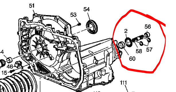

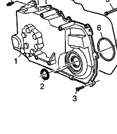

You are describing a bad axle and it needs a seal.
The passenger side has a stub axle that uses all of the parts (2, 56, 57), the driver side uses just a seal (2).
driver side

I'm saying the movement indicates a worn CV. I didn't notice that the thread had been hijacked. That is why it is better to start a new thread than hijack semi-related threads.

The picture I posted answer your question about the seal parts.
