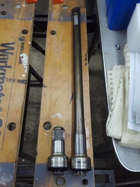

and a crude explanation of if the stub shaft comes out, now this guy doesn’t replace the cup seal but definitely should have. I would suggest replacing the outer seal and install the cup seal on the stub shaft , then install the stub shaft and cup seal assembly into the transmission and tap it into place with a block of wood and mallet or dead blow hammer, then install the outer axle seal, I tapped mine in with an ABS 1 1/2 inch plumbing coupler and a 24 inch length of ABS drain pipe . Then install the cv axle

To push the cup seal onto the stub shaft on either side
a member here indicated he used a 27 mm 12 point , 1/2 inch drive socket .

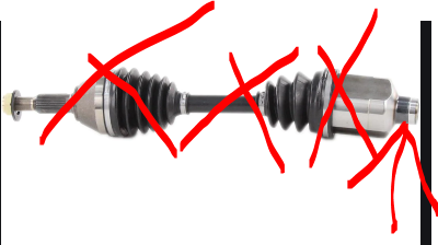

There is very little chance of nicking the seal, just pay attention to what you are doing. It is not "rocket science", just run of the mill square holes and round pegs. The only thing to worry about is: don't try to pull on the axle outside of the slip joint; only at the arrow.
