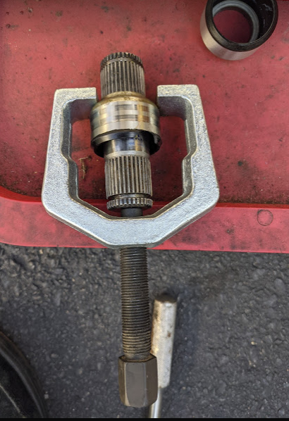

Completed this on Sunday. First off let me start by complaining about what an absurd design this is. Why can't the axle shaft just be one piece like every other car?
Anyways....
The stub remained in the trans after I pulled the axle. I removed c ring and devised a rig of 3 crowbars. 2 to grasp the c ring slit on the shaft and the 3rd facing the opposite way to hammer on. $30 of that and 30 minutes of trying and it was a complete fail. I then just took the prybar and pried it out. It came out instantly with no effort...sigh.
I removed the old cup portion from the stub shaft using a Harbor Freight Pittman arm puller. I used the puller to install it as well. I had 4 pairs of snap ring pliers, none of which were correct for this. A $1 harbor freight pick tool set also worked well as a substitute for the rings. The seal itself came out with a few repeated attempts around the circumference with a standard seal puller.

Jobs done, seals replaced, there are expensive specialty tools from Kent-Moore , but ingenuity provides a method to get the job done.
