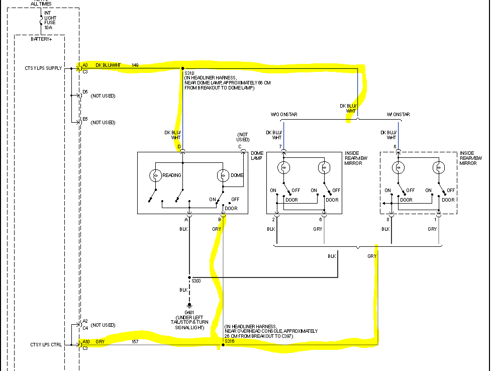

Hey guys, I managed to get my map lights switch to work, but now they only come on and respond to the switch when a door is open. Is this how it's supposed to function or is there a way to get them to turn on with the switch even when the car is running on the road (with the doors closed)?

They should light when you use the switch, no matter if the doors are open or closed

Sounds like someone rewired them. My guess is they switched the grey (lamp control) with the dk blue/white (lamp supply) wires.
