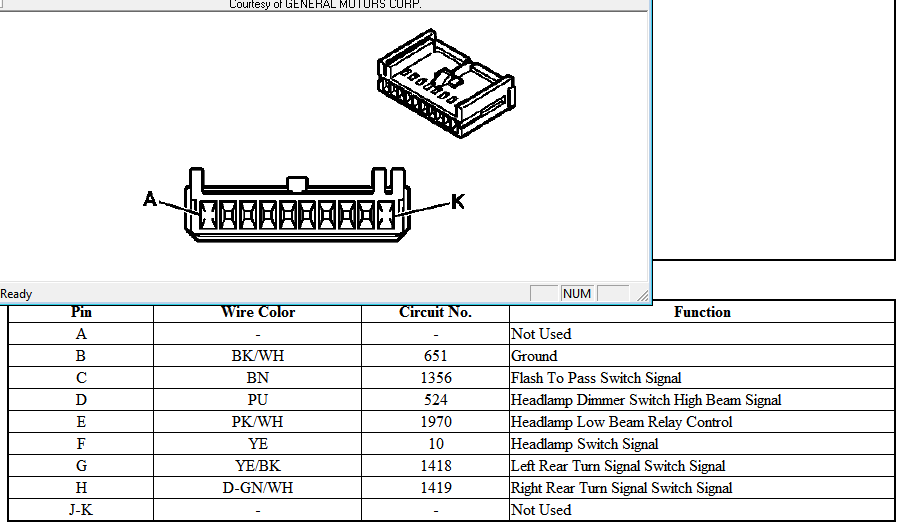

Since it is highly unlikely the BCM would break, just that one function, I would start looking toward the multi function switch.
I just don't know how a computer could forget one 0 or 1. Old fashioned flasher; yes. I guess it could, but pretty unlikely.
The multi function switch (turn signal stalk) has 2 connectors, this is the one for the turn signals. I think the signal sent is "ground". So, when turned to right pin H should have continuity to ground, otherwise it should be open.
