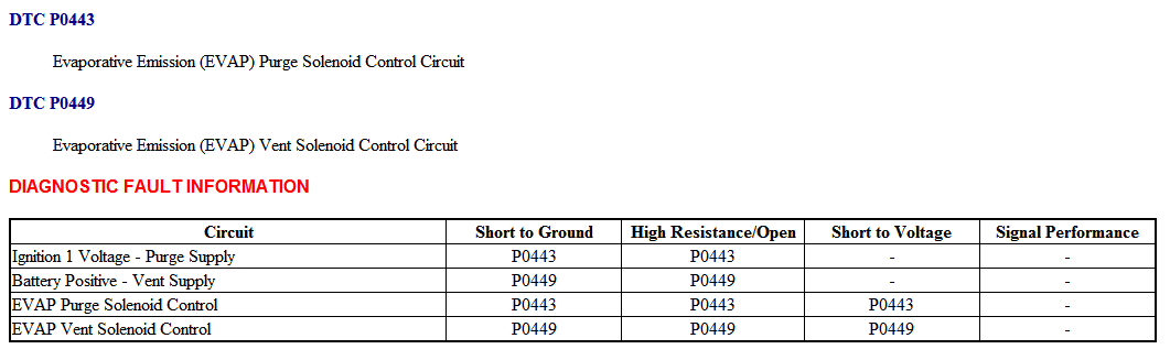

This is odd; Mitchell does not list P0445. But the web shows this:
https://www.obd-codes.com/p0445
If it is really P0443 it is the purge valve (under the hood)
The PCM/ECM monitors the voltage to the purge control valve and has detected a lower voltage than expected. It is a PWM circuit, not on/off.
Sometimes the ABS light will illuminate because the T/C is turned off.
Here is the VOM testing data for both valves:
Attachment 21751

P0455 is large EVAP leak. Frequently a bad gas cap, or the O-ring between the valve and the charcoal canister is bad or the valve is stuck open.
