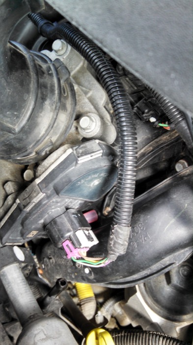

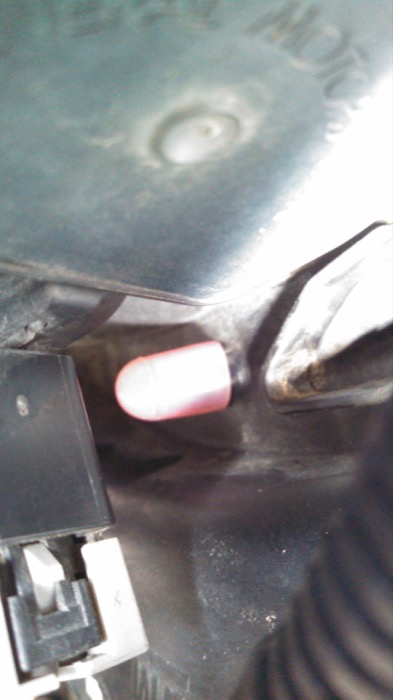

P0171 fixed
Pics show a little vacuum plug that we found had been chewed up by the mouse. Replaced with the pink one.
This is a 2.2 motor, the 2.4 doesn't have this vacuum spigot. Anyone know why? Whats it for?
Money spent, o2 sensor, serpentine belt was done as well. 330.00$ and still not fixed.
Starbucks grande Americano for friend, vacuum leak fixed. Less that $5 bucks.

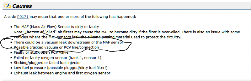

From the link in post #2
