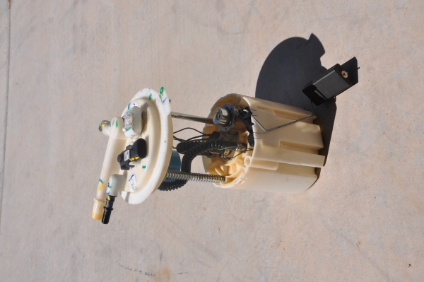

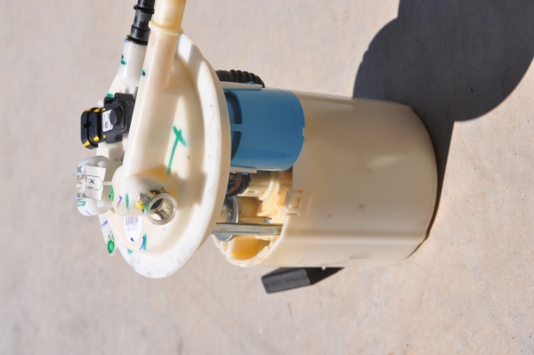

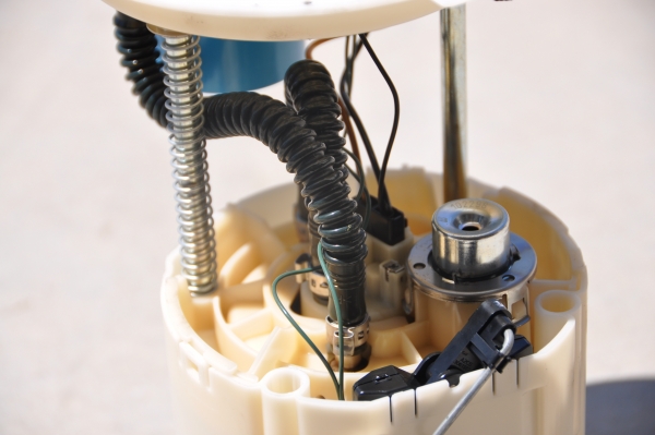

Pictures of the fuel pump. I was NOT able to see or find a check valve. Maybe someone can point it out to me?
Old May 5, 2015 | 11:25 AM
db/sb's Avatar
Joined: 06-26-2006
Posts: 1,876
It's likely built in somewhere along the outlet path and not a replaceable part.
Old May 5, 2015 | 01:29 PM
  #26
Posts: 26,533
My guess is it's integral to the pump part. Usually just a flapper of some sort.
