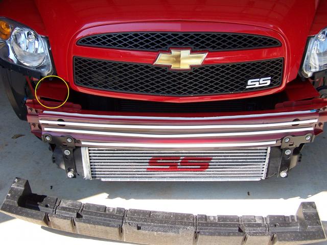

The temp sensor location is shown below. Yellow circle, behind that red metal square, attached somewhere around the unibody framing.
Donbrew has mentioned that in the latter years the sensor was moved to the grille area. Pretty sure on your 07 it's in the hard to find place like below.

That’s the location on my 2007 LS , Rockauto has them
