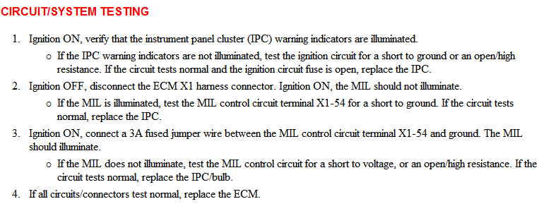

The CEL is controlled by the ECM by sending a GROUND signal; ignition voltage on the other side.
Have you tried to pull codes since this? There are a lot of U codes that might help.
Any other work inside the car?
From Mitchell OnDemand (MIL=CEL)
