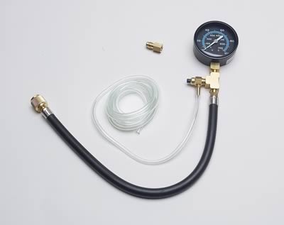

thanks for the input. now does anyone know what fuel rail pressure gauge to use on a 2.2

Use a standard fuel injection gauge 0 to 100 psi

Most parts store sell them and some rent them.

i was not very clear about the gauge. i meant a permanent install one just to leave on.

If it was a SS, that 100 psi gauge wouldn't even come close.
The SS high pressure fuel pump can put out some serious fuel pressure numbers. Check out this RPD shot from my car at startup.
There are lost of options for gauges. Look at summit racings web site. Also a very cool place to put the gauge is to get a pillar off of an ss and mount it on the post it will look factory.
A new one is expensive but you can find them use from time to time
