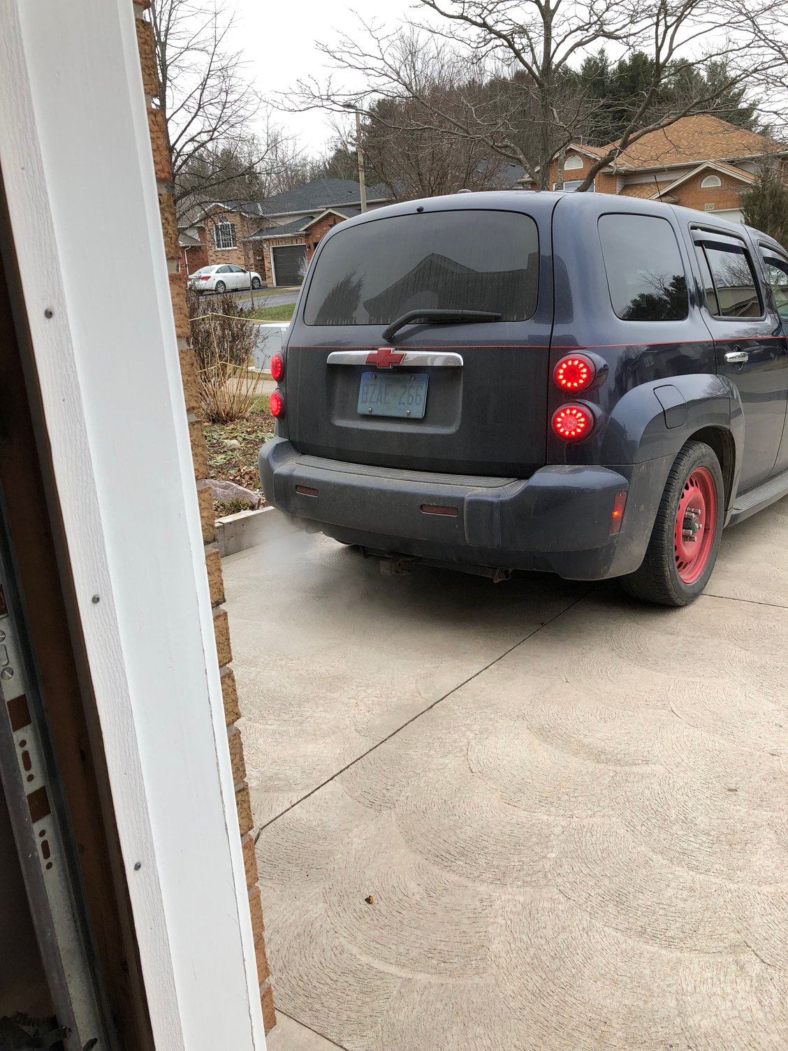

My RS, front signal or parking lights, side marker lights front and rear and the tail lights
And see the license plate lights.
Oldblue is online now
