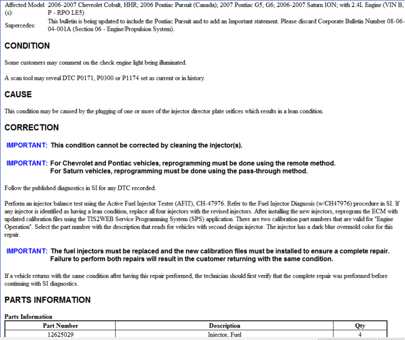

Yes, you can buy one at a time. Get the part number off of the installed injector. The computer is programmed to the part number.
There is a TSB on the subject for 2006-2007 2.4L. It may have been done on yours, so part numbers may be different. A TSB is not a recall. You can GoOgle the tsb number and get a full copy.
TSB #08-06-04-001B in part:
