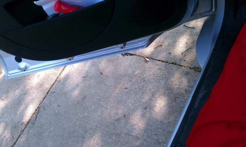

When we first got the HHR it had rust on the inside of the bottom of the door.
So the previous owner had it fixed.
We got the vehicle and it had to sit for about 3 weeks before we could reg. it.
When I drove it out of the carport the R.R. brake had hungup and it skided the tire for about 150 feet before it broke loose. It must have been rusted.
At that time I noticed the rust had came back on the door.
This is a picture of the repaired area 3 weeks after repair.

On the door issue, I'd take it right back and tell them to do it over, and this time to do it right. There is a way to unfold the door skin to clean out the rust, then prime/paint, and then refold the door skin before doing the final prime/paint/seal. If done properly it should be a permanent repair.
My big concern is that you may have a vehicle that was in a flood at some point, hence the questions about prior out of state registration. Its possible to "clean" a vehicle's title by transferring the vehicle to another state, what once was a salvage titled flood car in PA for example, becomes a clean titled "one owner cream puff" in NY...its done all the time sadly.

Is that rust on the vertical seem going up the door edge? (or just dirt, etc. Hard to tell from the photo)
No It's just dirt.

The reason I asked was that wouldn't be a "normal" place that some guys are getting the rust. If it had been rust it would almost guarantee that is had been "sitting in water"......

Definitely rust. Your corrosion warranty should go to 150,000 miles... pretty sure.Name:  IMAG0869.jpg
