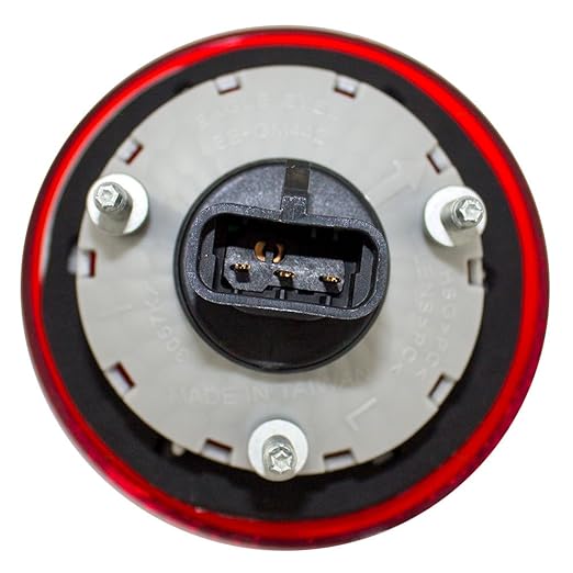

From your description JCC, and I might be misreading it.
It sounds like your gaskets ended up inside of the quarter panel between the taillamp bracket and the inner quarter panel. Instead of being in their proper location between the taillamp and the outside of the quarter panel as illustrated by the replacement lamp assembly below.
If the gaskets are in the wrong location, your HHR will leak like a seive around the lights.
Thanks for the input and support… here is what I did, Oldblue said to try the Butyl rubber sealant products. This is new to me and I wanted to try it, finding it was harder and took more time than doing the job. To help others with this part here is what I found… At Home Depot they have Elastomeric Butyl Rubber Sealant TAPE made by GSSI Sealants, #99415 Tape Butyl, 3/32 X ˝ X 45’. I put a strip around the lens on top of the old gasket, simple fix (see Reply #4 which shows the outside lens, back view, tape was put around the dark area… THANKS to 843de for the photo). There was still a gap in places around the O.D. of the lens (see Reply #4 the O.D. red area of the lens), so I filled this with RTV (clear). After 24 hours (plus) of rain/ storm I check the inside of the lens compartments and the wheel well… all dry, no signs of any water. Will keep checking it but it would have lots of water as before cases in the pass.
