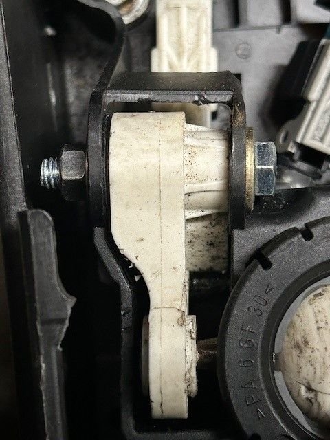

This is what I got, which doesn't match either part number listed above. It definitely came out of a Cobalt. I pulled it myself.
If it won't work in the HHR, I'll post it for sale on the Cobalt Forum or eBay.

That eBay listing is the ONLY search result for that number. The number is not anything in the GM parts database. My thought is that is a casting number, not a part number.
Not saying it definitely won't work. You could do some measuring, the mounting bolt spacing, try to determine if it will fit under the console, things like that. You'd have to access the shifter that's in your car now. Let us know how this goes!

The plastic pin that the left side of the shifter pivots on is partially broken. I drilled the end out and ran a bolt through the hollow shaft and secured with a nut. It's holding up so far. Both the shifter in the car and the one from the junkyard have "GM > PA6 GF30 < stamped into them at the front end toward the firewall , under where the cable ends anchor.
