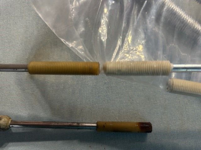

I'll give them a shot, but I'm not hopeful.
One set from eBay and one set from Amazon both had plastic end pins with a larger diameter that would not fit into the receiving clips in the shifter.
If this set is the same, I may attempt to sand the pins down to fit.

https://www.ebay.com/itm/28577439384...Bk9SR-zB6dy9ZQ
It is the same part number that Oldblue cited; don't know anything else.
This one doesn't fit either. Same issue. The pins are a larger diameter than the HHR. This appears to be the case for anything on eBay or Amazon that is made in China. I'm guessing all are the same manufacturer being sold by different vendors. Either a design flaw or maybe HHRs sold in China (if they were) are slightly different.

Your old ones look to be worn.

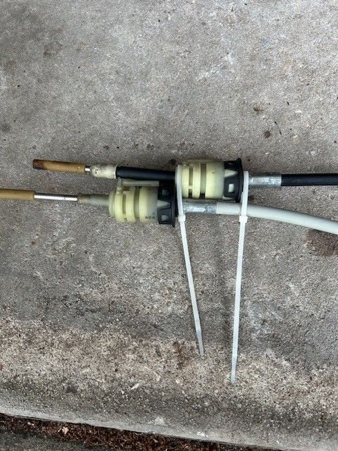

Originally Posted by tomasorta
hi tbox, at the end both shifter control are compatible for HHR and cobalt? I need to know, because I have similar problem I need to replace the shifter control for HHR 2006, 5-speed, trans-F23. Thanks
I completed installing the Cobalt shifter into my son's HHR. I found another Cobalt in a different salvage yard that still had the cable, so I grabbed those and installed them as well. All working fine.
One note, getting the cables through the firewall is a pain as the large plastic casings won't pass through together. I zip tied them, one behind the other to make it easier.
See photo below.
