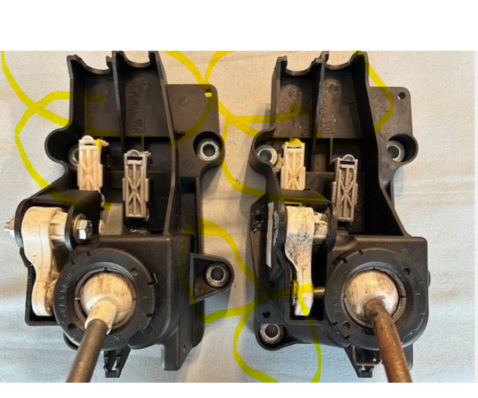

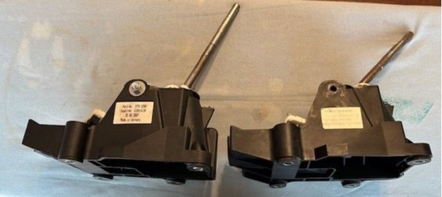

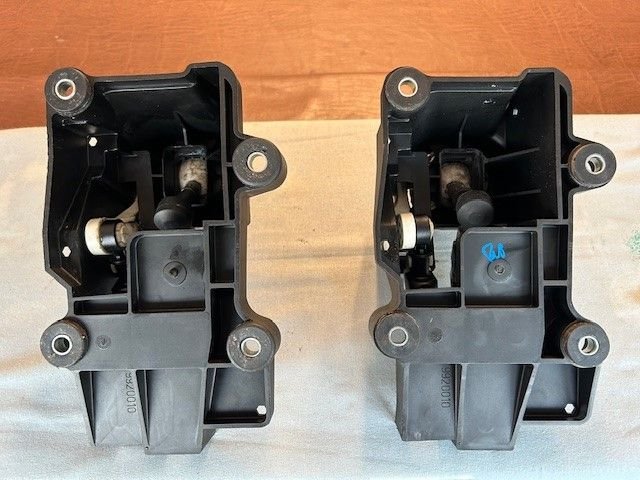

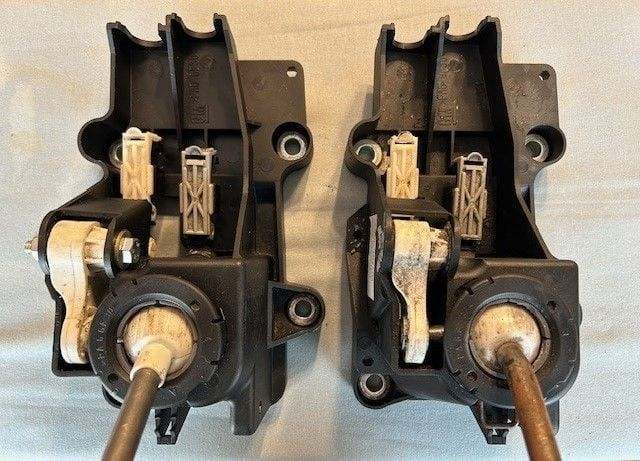

See photos below. In the photos with both, the shifter on the left came out of my son's HHR. The shifter on the right is from a junkyard Cobalt. They are identical including "GM>PA6 GF30<" stamped on the top and "9920010" stamped on the bottom.
I also checked and the shift cables ends fit correctly into the receiving clips. So, anyone in need of a manual shifter can check the junkyards for Cobalts as well. Still don't know why the part numbers are different, but if it works....
However, note the Suppl-No (Supplier Number?) is the same and both made in Germany.
Cobalt Shifter
HHR Shifter (with my home engineering repair)
HHR n the left, Cobalt on the right.

Is this an optical illusion? They look totally different to me. The mounting holes are different.
Old Jul 1, 2024 | 10:02 AM
Posts: 40,083
Possibly the left unit has a more robust nylon arm at the shifter ball
It might be camera angle.
Old Jul 1, 2024 | 10:37 AM
Posts: 11,721
Same shifter assembly but the main shifter arm is different between the 2. Is one of those longer than the other ?

If you look at the comparison pics from the bottom view, they appear to be the same. All that's left is installation and testing.

Does the shaft on the right look bent?
Did the Cobalt shifter work in the HHR?
