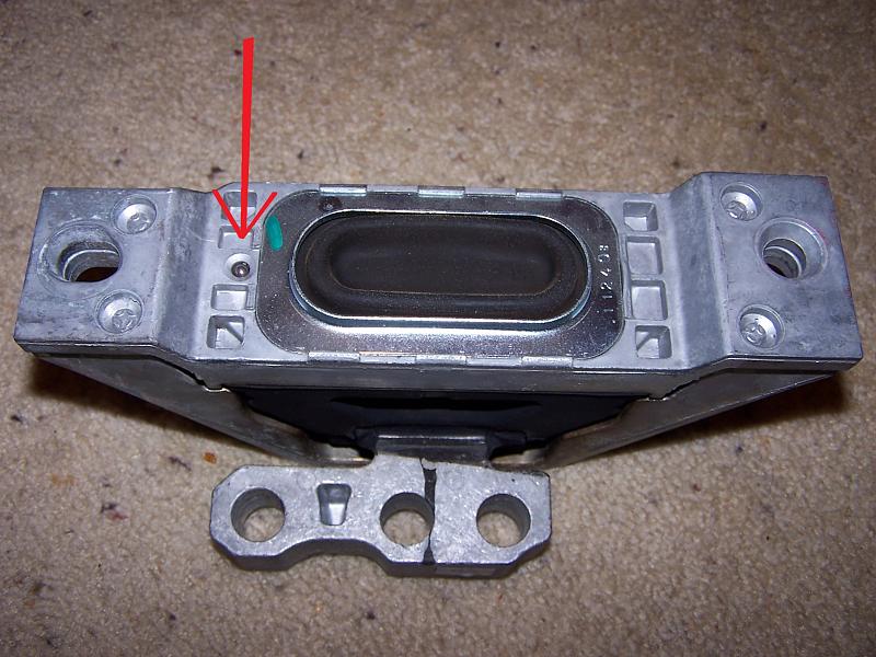

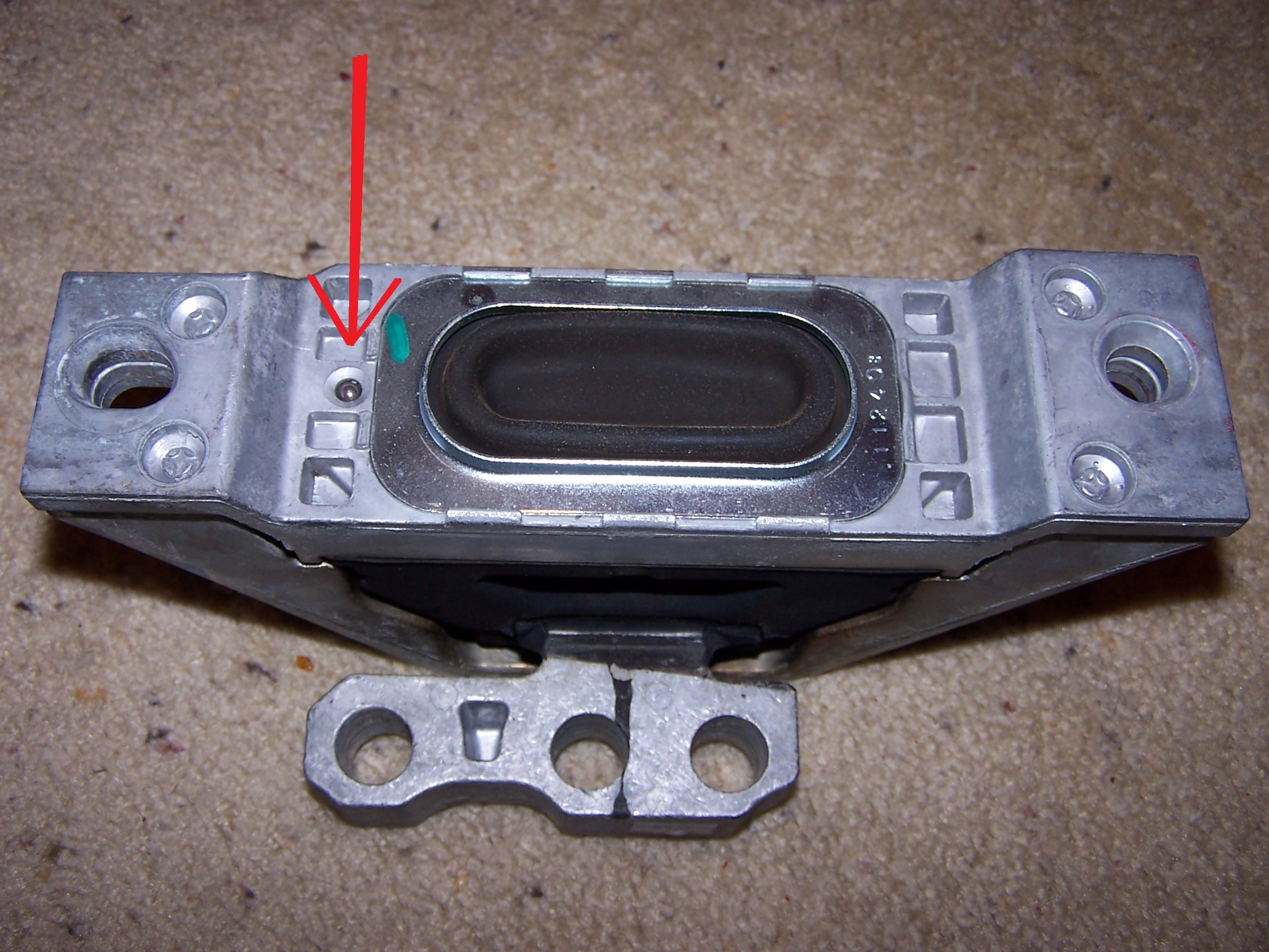

Not really sure why you tried to separate the mount into 2 halves. Should have just removed the whole mount, then reinstalled. 3 bolts, 2 nuts.
I looked at my old one. It is a factory sealed unit. Not meant to be taken apart or serviceable. Honestly, I don't see how you separated it. That "ball bearing" is just a spring loaded check valve. I'm sure that's the port they would use to put in the fluid at the manufacturer.
