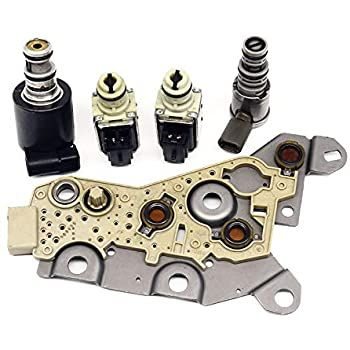

Most likely the solenoids failed , very common problem, but transmission shops think it’s rocket science, I always recommend replacing all of them, if you have the transmission side cover off
