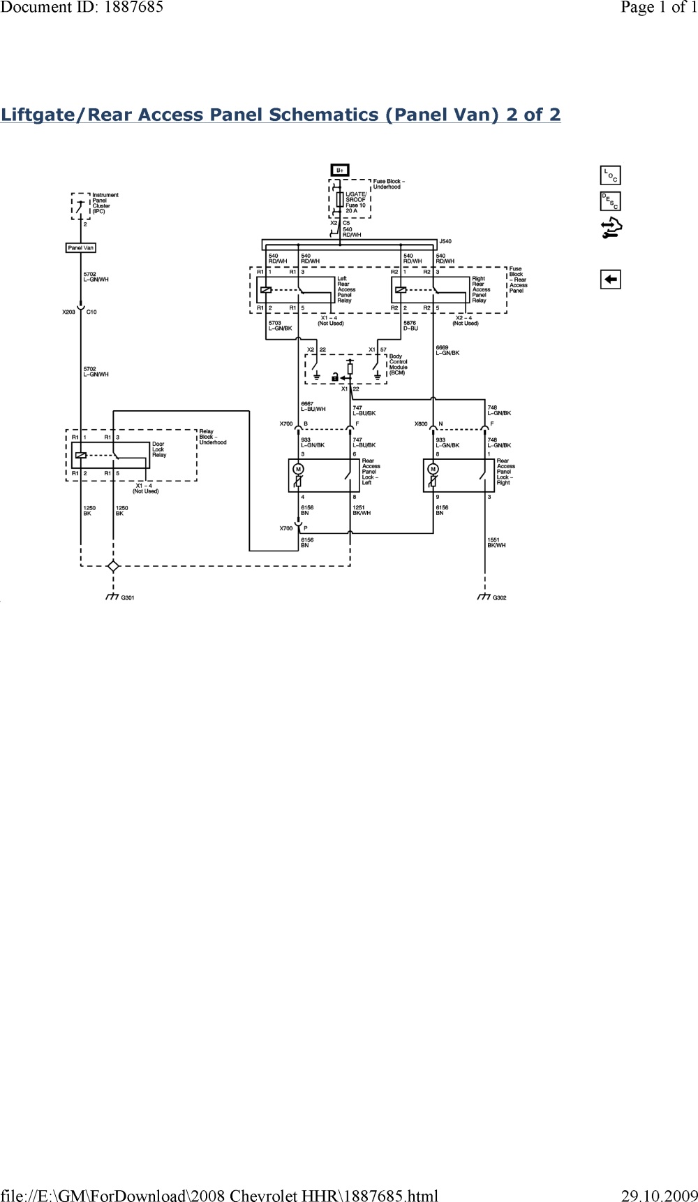

I did find a wiring diagram that shows the panel rear door relay is controlled by the instrument cluster.
Old Sep 27, 2015 | 06:46 PM
Well Lucky, as Ricky said to Lucy, "that sure 'splains it".
Good find!
