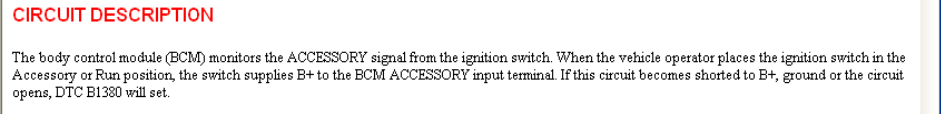

You said it was factory stereo. If the PO tried to install without a GMLan module he probably tried to steal a signal from some silly spot. Which is why I asked about it.

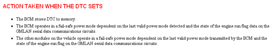

B1380 pertains to the ACC circuit. 01 is a short to BAT. 02 is short to ground.

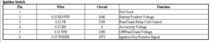

Here are the color codes out of the ignition switch and the key lock
