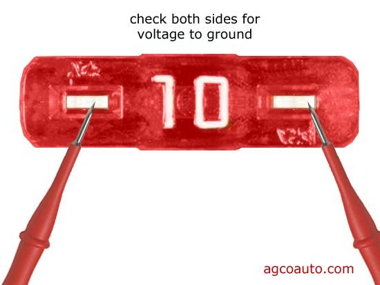

I assUme that you checked for voltage on BOTH sides of fuse #30?

What do u mean by check both sides? +/-? Yes i did that.
just tried another test. Pos to fuse box 30 and neg to shock tower bolt (ground). Get 12 volts on surrounding relays and 29 AND 30?!

Fuses have 2 ends. One end has power from the battery the other feeds the circuit. There is no +/- on a fuse. With a good fuse in the holder both ends should read 12V, if only one end has 12V the fuse is bad, if neither end has 12V there is a problem in the guts of the box.
I meant the tabs and slots between the box halves.
If you have 12V on both ends of fuse 30 but no power to the outlet there is a bad connection or broken wire somewhere between the fuse and the outlet.
The pin at the bottom of the outlet is + the sides are -.

Ok so i tested with fuses in place & neg volt meter lead to shock tower for ground. Getting 12v both sides of 30. Same as 29 for comparison.
checked coltage coming out of front (29) power port 12v.
Rear port is registering but only like 0.15v or so.
