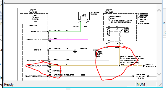

Tail lights, marker lights, interior lights, license plate lamps etc. all share the same Brown wire feed.

There is a vague connection in that the brown wire FMG points out goes to the BCM as a signal of some sort.

Thanks for the diagram, that helps. SOOOO sould I be looking for a break in the wire somewhere. No that wouldn't be the cause because they will work at first for about 5 sec, then go off.
