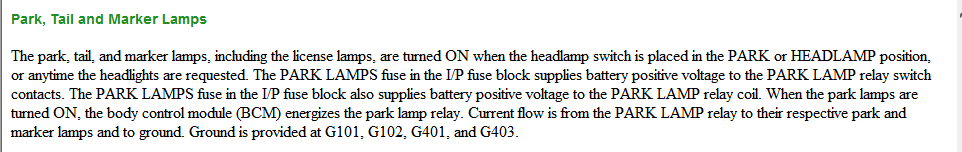

If it is not the relay it must have something to do with the signal from the BCM to the relay.
Still don't get how the tails could work without the markers.
Any LEDs in the circuit? Brake lights (all 3) working

No LED's that I know of. all exterior lights work but running lights. I would have to check plate lights, never looked at them

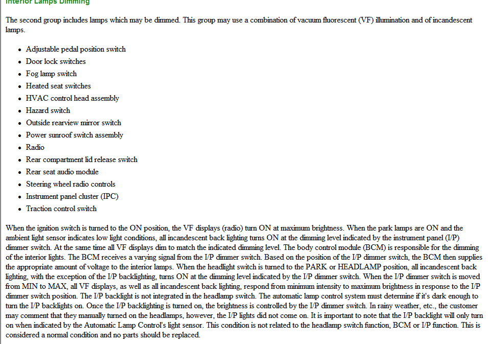

This is with the headlights in the ON position not AUTO?
Do you understand how the I/P lights and DRL and headlights work through the light sensor?

I/P Lights? And yes they act the same weather on or auto, no running lights

I/P=instrument panel

WOW thats alot to take in lol. So could the Automatic Lamp Censor be the problem? does that relate to the grounding of the relay that made them come on like they are suppose to? Thanks Donbrew
