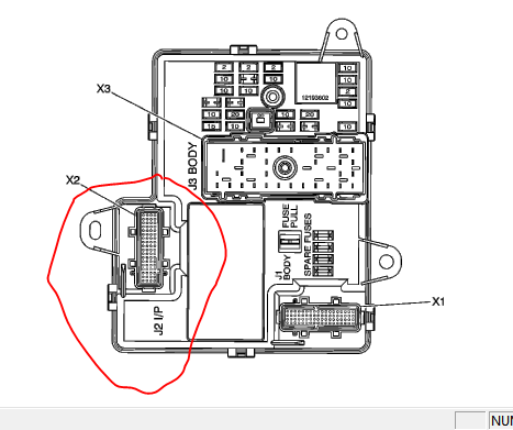

First thing is to check continuity of the white wire from the BCM to the relay, and check for signal (ground) on the same wire.

That is continuity between
this on the BCM (inside fuse box)
And this on the underhood box, probably pin 85, but might be pin86, the other one should be 12V. 87 should be 12V. 30 goes to the bulbs.

I will have my mechanic check it, I don't know how. Thanks for the clear diagrams
