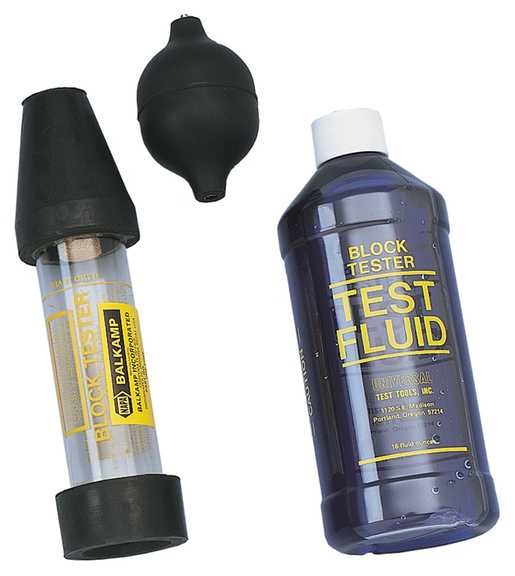

The first thing that comes to mind is a head gasket problem of you still have air trapped in the cooling system from you last repairs.
An easy way to rule out the head gasket is to rent a block tester from your local part store.
