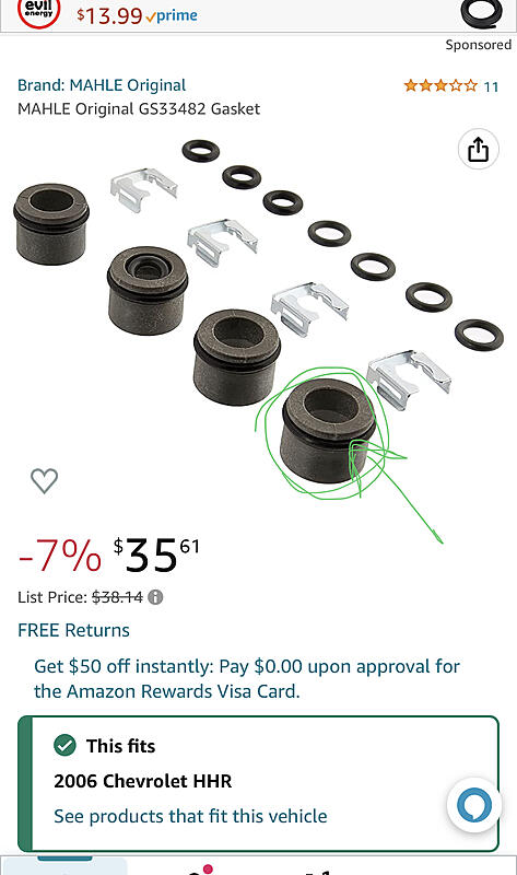

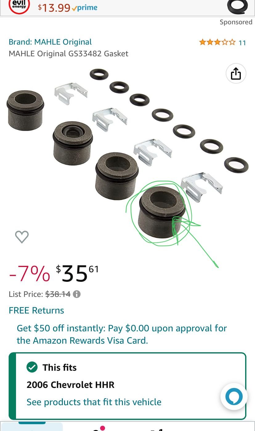

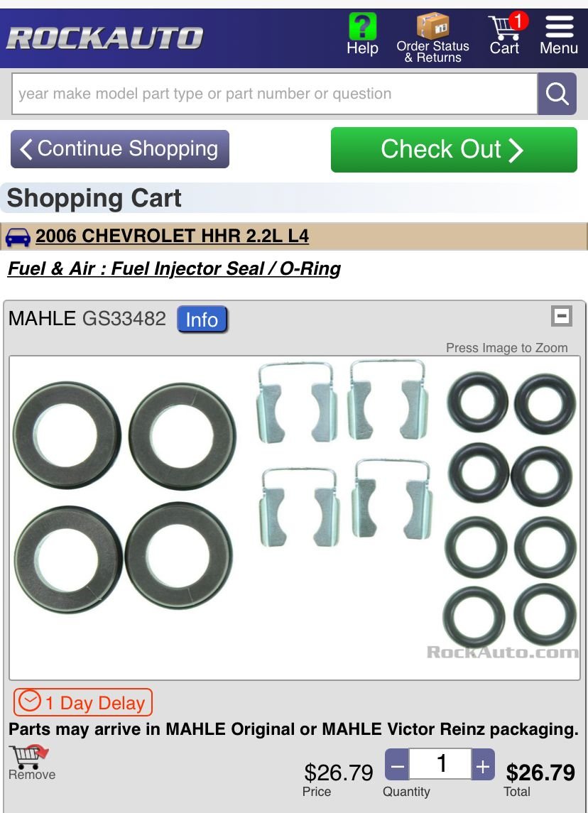

pulled fuel rail and injectors again to run cleaning thru same as seen a few people do on youtube. Two gaskets are shot. Think need a rebuild kit like this?
mine are yellow but this kit they are black casings with gaskets? I thought i could maybe just replace the gasket itself but the sizes listed on RA seem to be for the other smaller injector gaskets
