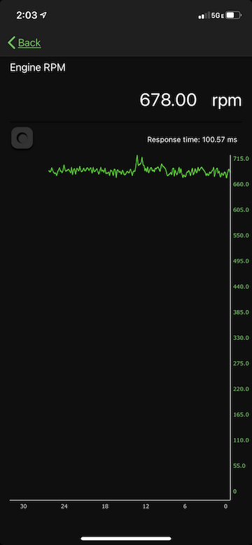

so bought a 2 gal gas can and dumped it in.... third attempt starts up just fine. Car was frickin' out of gas!
smoothest idle i've seen in a while. waited for a while and so far p0134 code came back after a bit as pending. Will drive it around a bit - go fill it up etc. and see what else comes up or clears.
