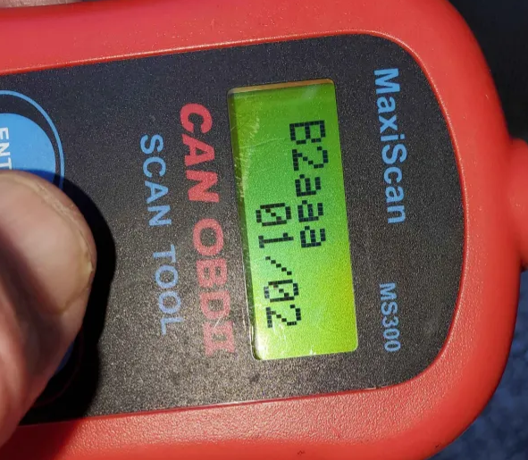

Next time, before your Dad clears any codes , write down the number, then post the numbers here .
Oh, actually that was months ago, I took a picture of it! the code was B2aaa. I'm misremembering.
Aha "the B2AAA code will come on when You insert a scanner tool into the OBD II port that is not compatible with the vehicle"
WELL that is interesting, that code did not come up yesterday. I wil doublecheck the one I bought is compatable with the HHR.

Junk scanner, lots of bad reviews on Amazon.

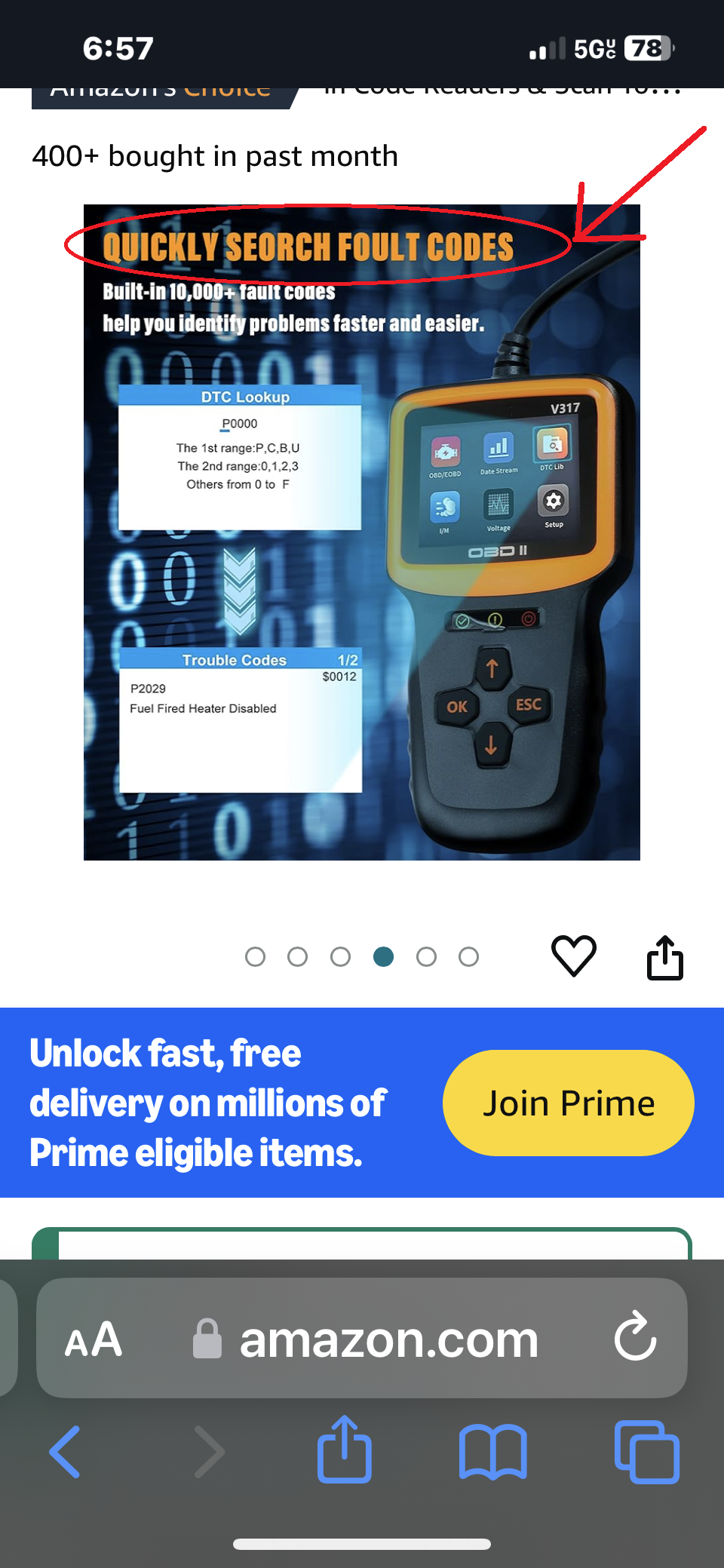

Well, i know what i'm getting my dad for Xmas! here is the one I got,
Amazon Amazon
It arrived, just gotta drive out to my mailbox, will do that in a bit, and try jumping the AC clutch.

Originally Posted by raptor
Well, i know what i'm getting my dad for Xmas! here is the one I got, https://www.amazon.com/dp/B0C3QYT4LY
I'm always leery of Amazon ads with simple words misspelled
https://www.chevyhhr.net/forums/atta...1&d=1723507755
Attached Thumbnails Pending repairs on my '06 LT: Radiator fan not running, warm A/C.-img_1323.png

It's just a typo from the worker translating a chinese product, like so many of our products... it does have a lot of positive reviews but really this is intended as an entry level one, will see if i want to spend a hundred plus later.
I tried it out, it works, no 'incompatability' error code. And it was neat seeing an RPM graph, and lots of other data, pulled up my VIN, lots of functions.
