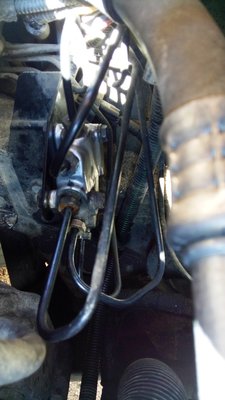

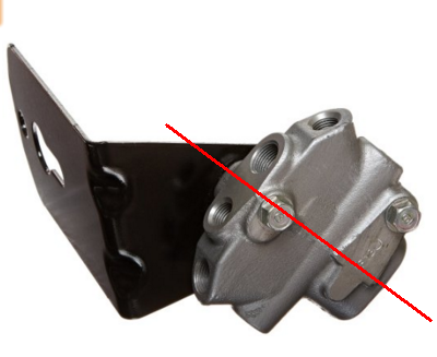

It is not divided into two chambers?

I didn't say they are not separate. Please look at the cutaway view of the master cylinder and note the different sizes of the piston chambers. The one that serves the front brakes (closest to the firewall) is larger than the one that serves the rear brakes. Would it make sense to split your way?
There is stuff inside of the block that balances the pressure and directs the flow
I am assuming you have Mitchell OnDemand, I got mine from Russia, so finding that drawing should not be difficult. But if you do have Mitchell, why ask us to look ?

Excellent. In accordance with the figure. RR and LF one camera, LR and RF second.

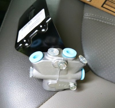

Proportioning Valve replaced. ACDelco 21994163 not found, bought ACDelco 25852935. They differ only in the mounting bracket. The brakes started to work perfectly.
