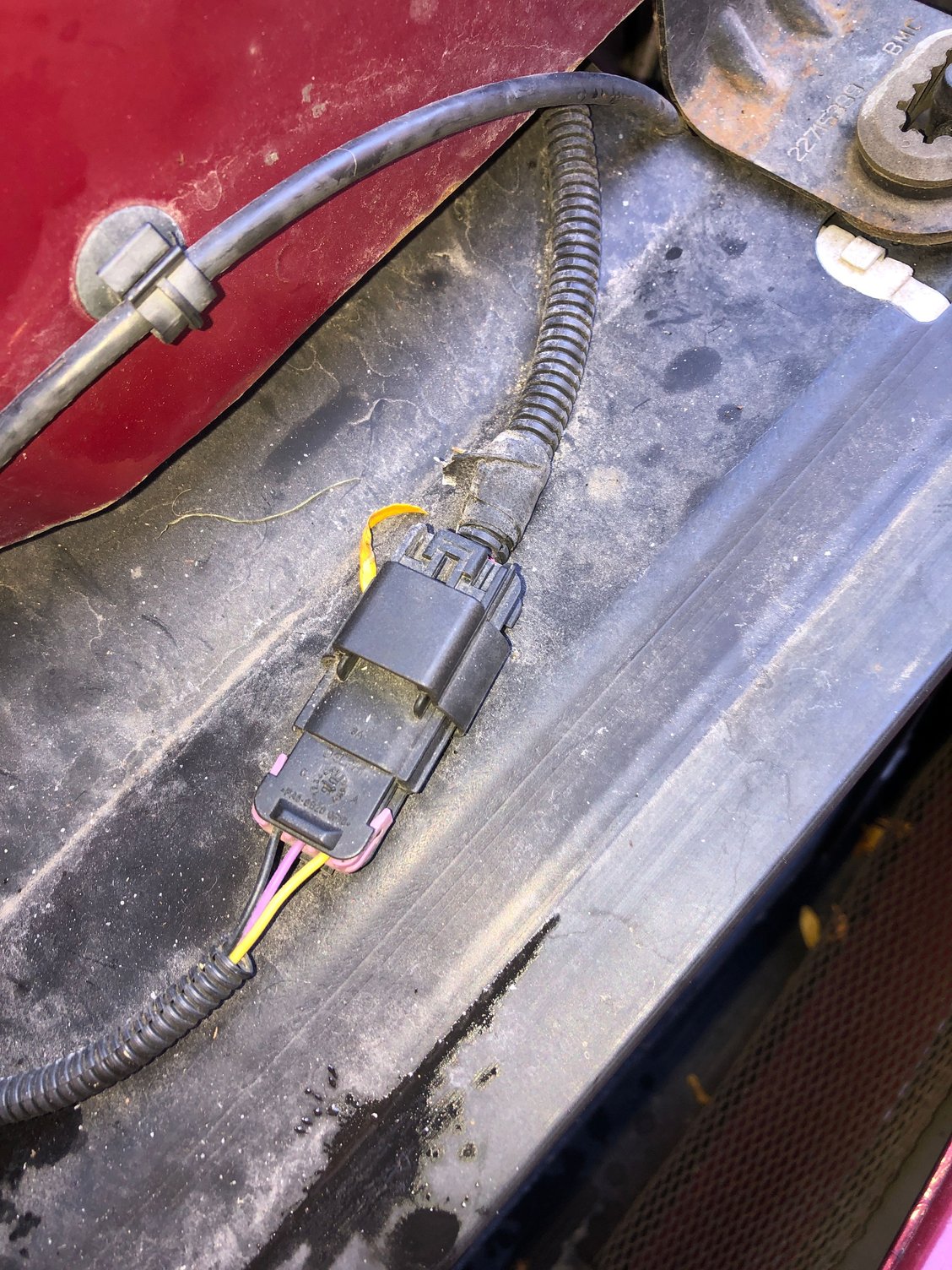

That plug appears to be the MAF sensor connector.
I agree with RJ , fix that hood latch.
I need to correct my response to the plug question in post # 27 , it’s for the hood latch switch for the remote start
Here’s a photo of one connected to the hood switch

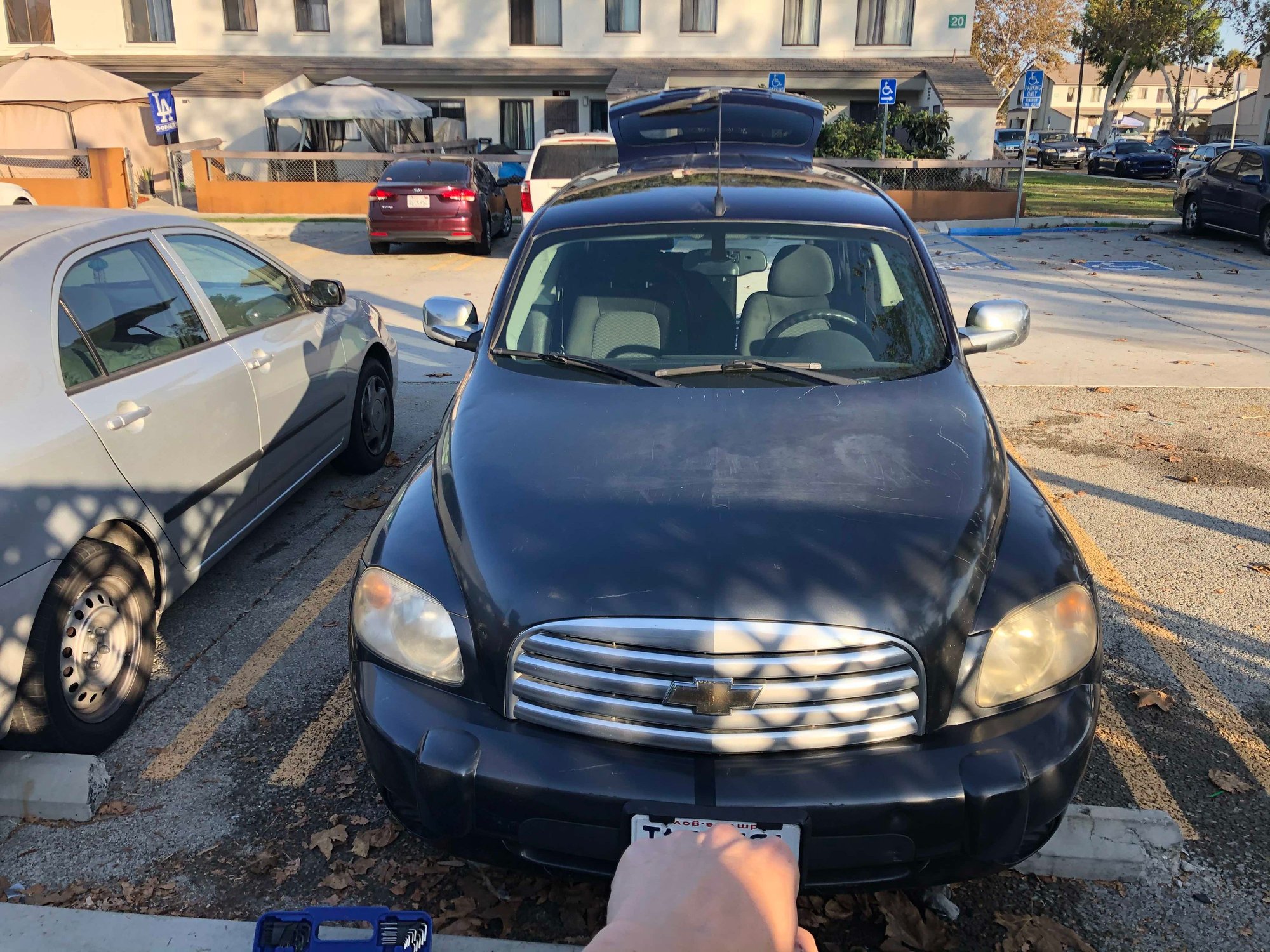

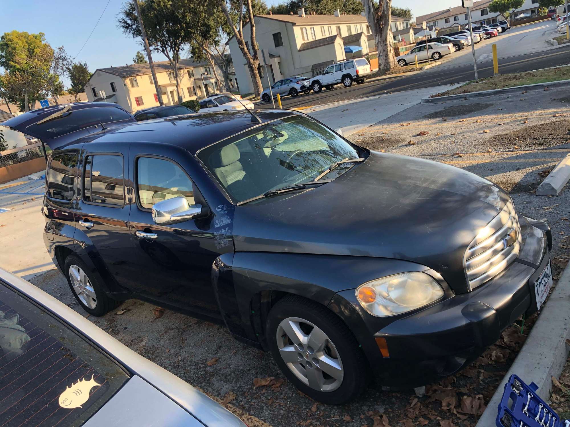

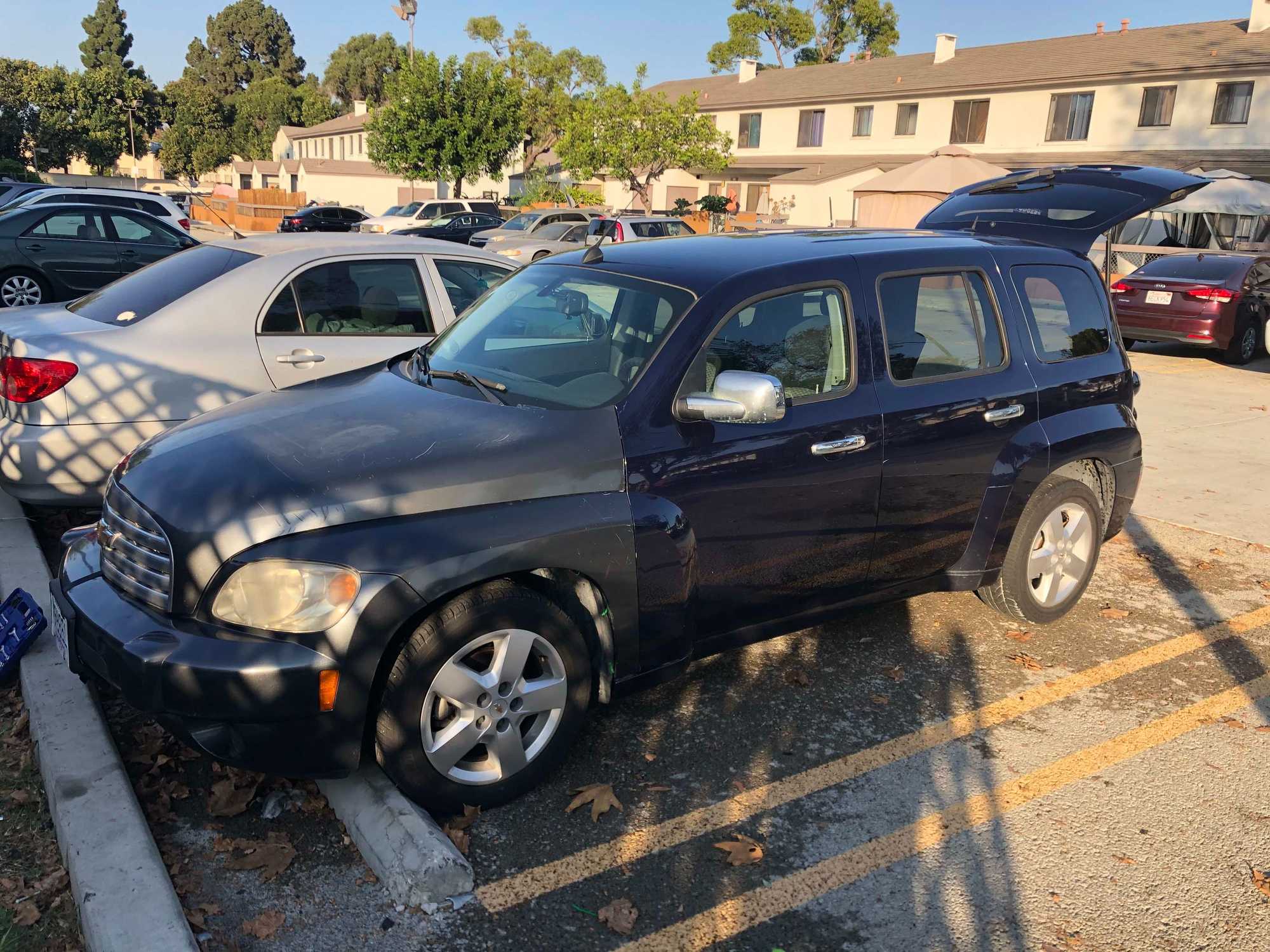

thanks for the responses. I ended up not going with a zip tie solution and I bought some ratchet ties from harbor freight. I went through the hood latch and then around the bumper. I tried pulling up on the hood and shifting it and it isn't going anywhere. What do you guys think?
Also, here is the car with the "new" hood and bumper. Not very pretty but good enough for me.
I was wondering why my remote start had stopped working lol.
I wonder where my plug is for that because I couldn't find it anywhere...

Do not trust? Conduct an experiment: put your hand in an open window with an open palm at a speed of 60 mph - you will feel strong air resistance, it will be difficult for you to keep your hand straight. At 90 mph, this is not possible at all, even if you shade your hand forward.
The exact same force is acting on your hood. Yes, it is made of solid metal, but its area is several tens of times larger than your palm.
Without the hood lock: your hood will be uprooted and it will kill you, or the passenger, or an accidental victim from behind, or all three at once. Even a poorly adjusted lock can lead to tragedy. You've seen bonnet locks on race cars, haven't you? This is specifically to prevent trouble.
Leaving "core support" as it is now is not recommended either. Radiators are attached to the core support, they will be located crookedly. This means increased vibration when driving. the area of ​​the radiators is large and the weight is also significant. Thus, after 3 - 4 months the core support metall will start to break, communication lines may come off. You risk overheating the engine from loss of coolant, kill the transmission from loss of transmission fluid.
I understand that your decisions are dictated by severe necessity. We are all going through difficult times and have our own reasons.
What can be done in this situation:
Get a good steel wire (not electrical wire, not aluminum cable, not nylon rope, but steel wire). Pass it through the hood loop with one end, wrap it around the front bumper reinforcement with the other end. Twist both ends tightly so that the edge of the hood is pressed firmly against the bumper and the hood has no up / down play. Use a screwdriver For twisting, but do not scratch the paint.
The strength of the steel wire will be close to the strength of the steel lock, although not equal to it. You will get a couple of months of safe driving. During this time, you will find a way to bring the car back to its original condition. Of course, uncomfortable opening the hood, but you don't go there every day. Before securing the bonnet with wire, check all fluids and fill the washer reservoir.
Duplicate the first wire loop with a second loop, but less dense. If the first hinge breaks, the hood won't hit you right away and you will have plenty of time to stop. Twisting the remaining second wire loop more tightly, you can continue driving to the repair site. Do not fix the hinges on the radiator grill - this is a weak plastic, will not last long.
Thank you for the advice. Do you think my ratchet tie solution is sufficient with period checks until I can afford to have the core support replaced?

about ratchet ties - this solution looks aesthetically pleasing and durable. The main thing is that the hood has no up / down play. Inspect more often. Otherwise, the bottom of the plastic bumper cover is at risk. Of course, when tightening the ratchet, fanaticism should also be avoided so as not to crush the plastic.
