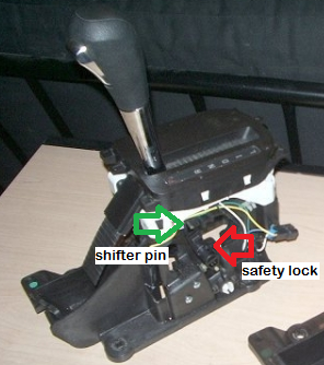

My problem was more simple. I simply could not take it out of Park.
As a safety feature, you can't shift out of Park unless you step on the brake. After you step on the brake, you should hear a click. This click means the safety lock was released. Then you press the shifter button and hear another click to move the shifter freely. So there are two things put in place to keep you from shifting to another gear accidentally - the brake pedal and the shifter knob button. My shifter knob button was making the clicking noise, but the brake wasn't making the noise.
After removing all the plastic panels in the center waterfall between the driver side and passenger side, I was able to see the mechanisms of the shifter. Pressing the shifter button basically drops this metal locking pin so that you can move the shifter freely. However, there is a black plastic lever that prevents that pin from dropping unless you step on the brake first. This is the safety lock. The little black plastic lever is towards the bottom of the shifter assembly on the left side and you can only see it if you take out all the panels. If you press the shifter button and it clicks, you can see metal pin moving down but being stopped by this black plastic piece. Stepping on the brake is supposed to move the plastic piece to the metal pin can drop down fully.
Sorry if it's hard to see in the photo, but you can kind of make out the small pin that drops down and the black plastic piece that keeps it from dropping.
Luckily for me, I just checked all wires while I was taking things apart to make sure they were not loose and my brake was finally allowing me to shift again. So I think one of my cables was just loose. But if that doesn't fix it for you, you can consider taking the shifter assembly apart and just removing the safety lock altogether so that it doesn't require the brake to release it. This comes at the risk of safety, of course.
