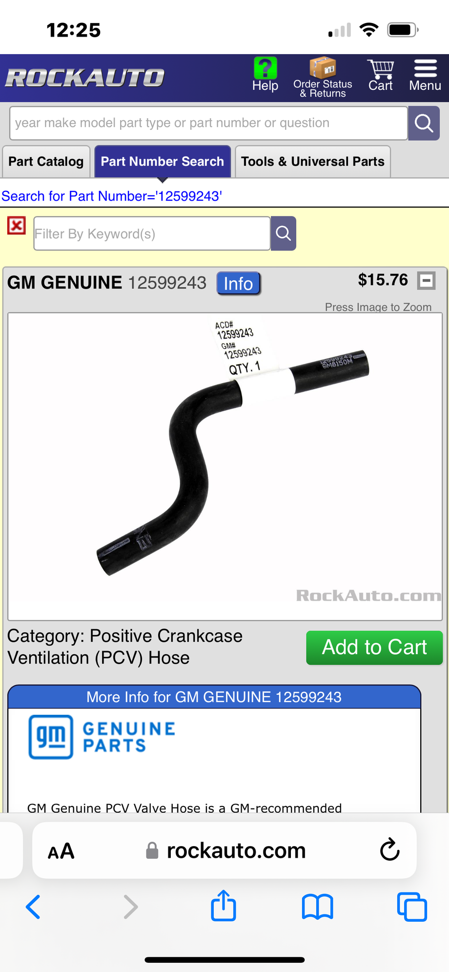

Timing chain has been replaced, probably less than 5000 miles. I think I will try replacing the solenoids before going that far. What is name of the hose from the valve cover??

Is it #18?
Hose - PCV.
Part Number: 12599243
Supersession(s): 12596232

RA has it listed.
