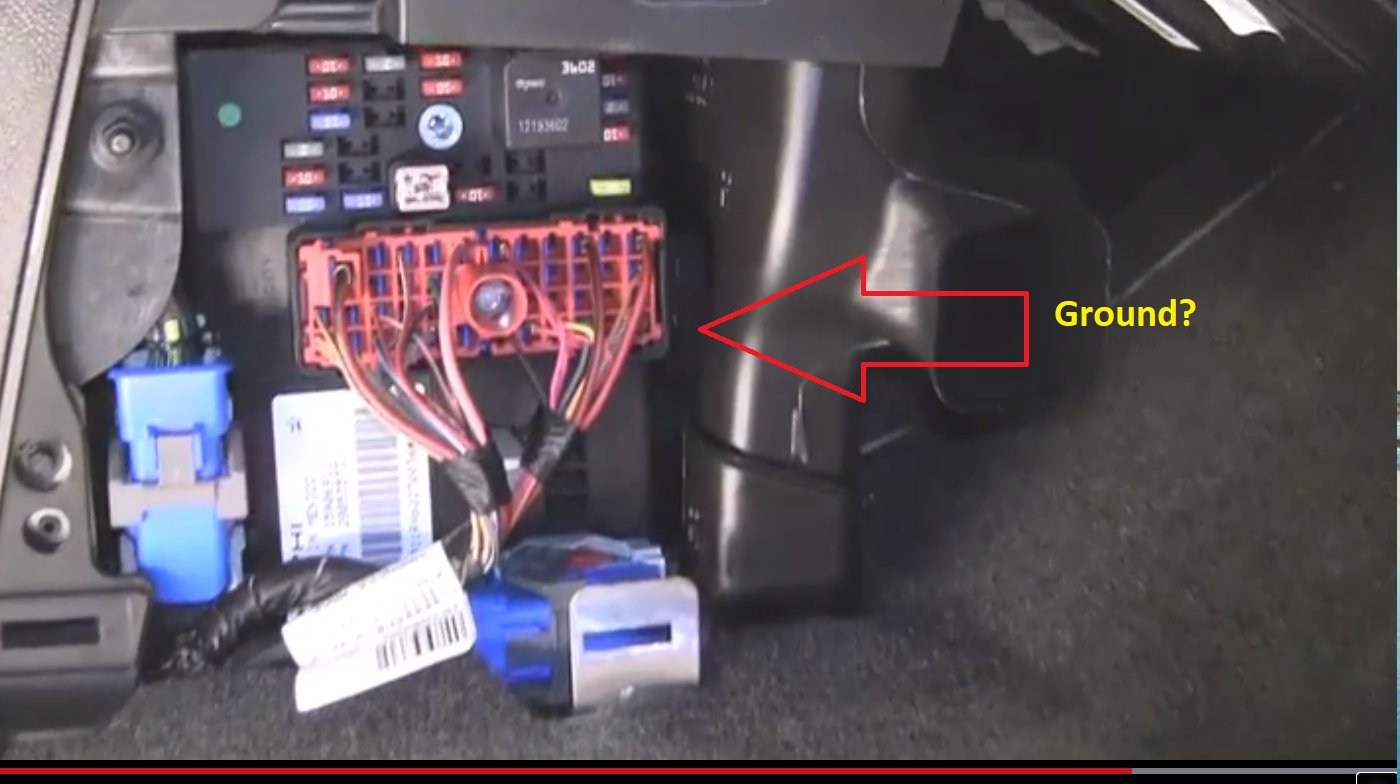

thanks guys, so this is the ground in the fuse block?, and how I can test if the ground is ok?, thanks
Old Oct 29, 2020 | 11:50 AM
Posts: 26,542
I missed the huge black arrow in the pic, too. Yes, that is the connector I meant; the wires to it are a bit tight inspect them for fraying etc.
No not a ground. There is no "ground in fuse box".
My experience has been that when filling and burping the cooling system some liquid always ends up on the alternator and usually the radio has static until it dries up. Past that, I don't know anything about your car and it's many oddities.

so by the way where is the ground cable? is two fuse box one in the passenger side another underhood close to the engine, thanks so much.
Old Oct 29, 2020 | 01:03 PM
Posts: 40,097
Ground locations
https://www.chevyhhr.net/forums/www....ad.php?t=56504
the one in the back by the battery
the one in the transmission down to the right of the oil filter cap
the one in the rad cradle above the drivers headlight.
