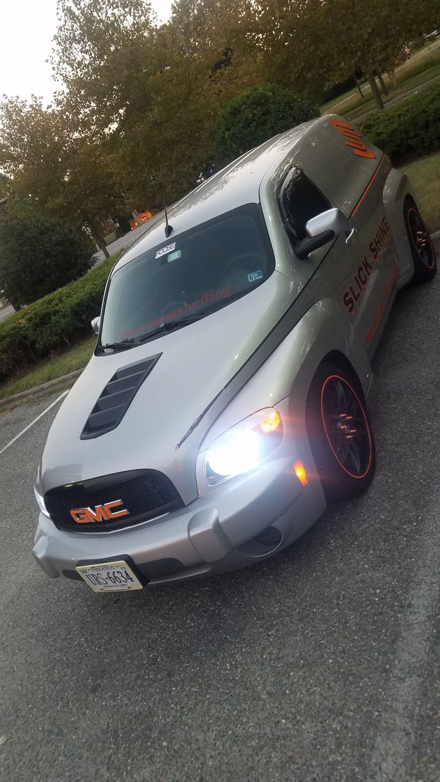

The problem is obvious! That GMC Grille emblem!
