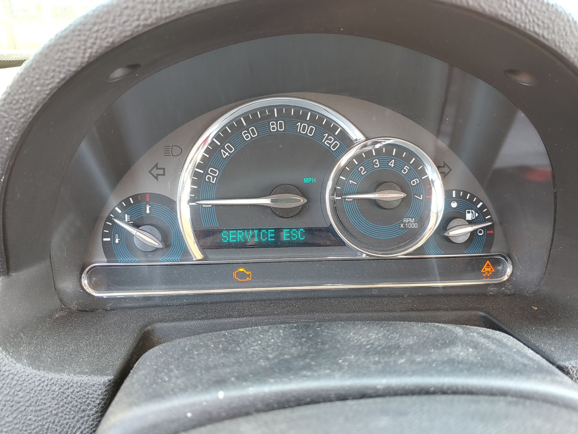

AutoZone's scan tool only reads CEL codes, not ABS. BUT!... O'Reilly's scan tool did read the ABS codes.
Here's the dash.
Here's O'REILLY'S scan results of ABS, which I found on the tool by clicking that middle button on the left, SYSTEM STATUS.
C0460-5A

How do you read ABS traction and steering data with a scan tool, LIVE?
I saw one video where somebody diagnosed their wheel speed sensor using live data from their scan tool, I'm wondering if something like that would make the problem obvious in my situation with this c0460-5a code thrown by the ABS system? Or, how can I recalibrate the steering angle sensor?
