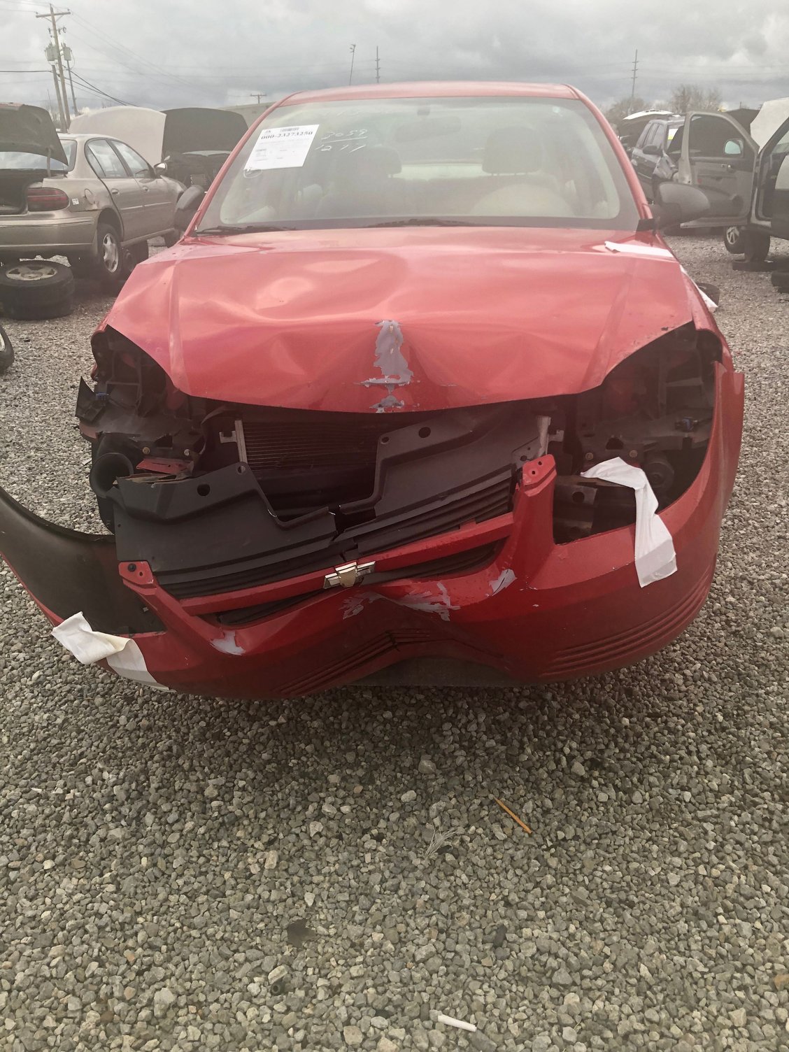

In the consideration the engine is shot I went to a local u pull it place. I will brake the cars up into a couple posts. They all started and ran at the insurance companies.
The silver one has maintenance sticker under the hood which is a good sign. But higher miles
any opinions would be great.
